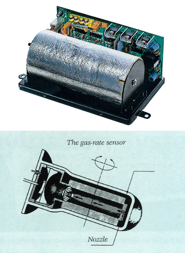

Kume had no idea of what the future would hold, but during a visit to a training site of Japan’s Self-Defense Force, he noted that a tank’s gun barrel was able to maintain sight of the target – the so-called ‘zero-target’ point – regardless how much the tank off yaws as it moves across rough terrain.
He was told this was possible by using a gyroscope device (below).
Upon hearing Kume’s idea, one of Tagami’s staff suggested that a gyroscope can be adapted for a navigation system, with the ‘zero-target’ now set to the target road.
The general idea was that if a driver knows where he started from, a system that is able to continuously sum his total distance covered and the direction of travel, which should in theory able to guide a driver to his destination.

Although initial tests showed promising results, Honda found that the system’s accuracy was highly dependent on the ambient temperature, which affected the helium gas inside the gyroscopes.
To improve the gyroscopes, Tagami approached Stanley Electric, the only company that agreed to support Honda’s project, which many thought to be a ridiculous idea to pursue.

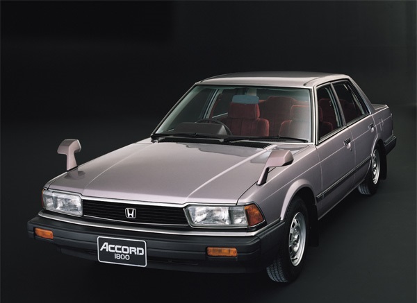

On August 1981, Honda introduced the Electro Gyrocator as a dealer option for the Japanese market second generation Honda Accord, which went on sale the following month. The feature was also offered for the Accord’s upmarket twin, the Japan-only Vigor.
Considering that the task of creating the map fell squarely on Honda, the feature was prohibitively expensive, reportedly costing a quarter of the car’s selling price. Clearly it’s not going to be a commercial success. The feature was discontinued a year later and was not introduced to other markets.

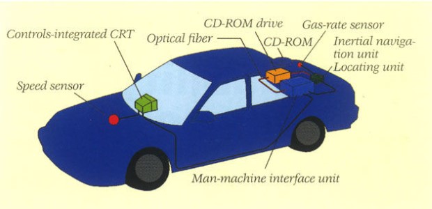

Nakamura’s system was able to do ‘map matching,’ a function which allowed the system to identify its current location simply by matching the car’s direction of travel and road patterns with the digital map. If you think about it, that’s a hugely challenging task!
Further complicating matters was Honda’s insistence that the map must be easily changed or updated by the user. Several storage mediums were explored – disks, floopy disks, microfilms, but none were suitable, so the project remained stuck in its tracks for nearly a decade.
By the late ‘80s, CD-ROM technology was entering the market. The storage technology that Honda had been waiting for was now here and the project could be resumed.

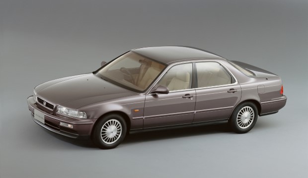

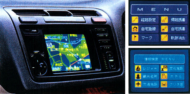

Honda’s first digital map-based navigation system was launched in 1990, as an optional feature in the Japanese-market Honda Legend (below). GPS is still not available yet.
